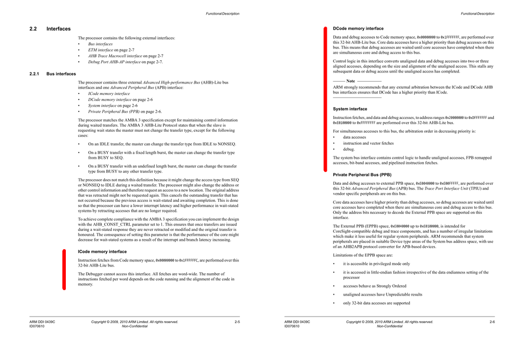

In my understanding, everything below 0x2000 0000 is fetch by the instruction bus.
