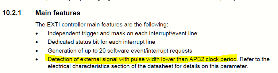

What is the exact meaning of''the EXTI can detect an external line with a pulse width shorter than the internal APB2 clock period'' in STM32F1
Rashad Shubita
Posted on December 28, 2017 at 13:31
Please if anyone can explain this to me!
Thanks in advance.

A minimum pulse width on EXTI is enough to trigger the interrupt. This minimum pulse width is not dependant an th APB2 clock frequency,
Posted on December 29, 2017 at 17:28
But is likely dependent on the resychronizer at the pin.
Posted on December 29, 2017 at 23:15
Clive,
this has been discussed a couple of months ago, and as Edison from the ST Prague support group confirmed, EXTI is surprisingly asynchronous.
Jan
