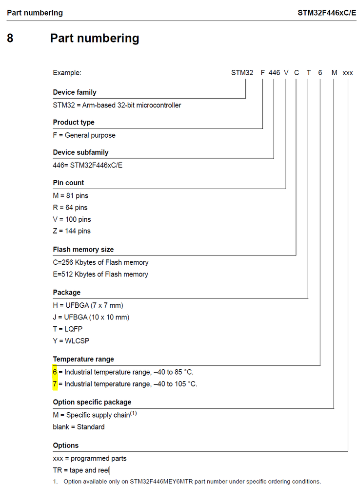

What is the difference between STM32F446RET6 and STM32F446RET7?
SLibe
Is there any documentation on the differences? Are these two part numbers functionally identical?
They have different temperature ranges.
The datasheet describes the part numbering scheme.
