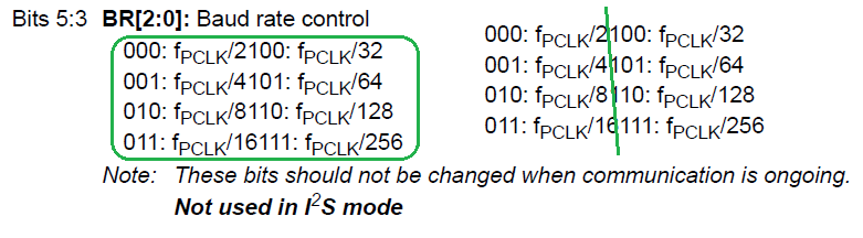

do you know why the reference manual shows 2 values of clock divider for each setting of the baud rate control register on page 715 of the reference manual RM0038?
I'm look at RM0038 Rev 7, which figure/table is that?

27.5.1 page 744 on rev 7
Posted on April 16, 2013 at 17:58
PDF sucks
000: fPCLK/2
100: fPCLK/32
001: fPCLK/4
101: fPCLK/64
010: fPCLK/8
110: fPCLK/128
011: fPCLK/16
111: fPCLK/256
george239955_st
Posted on April 16, 2013 at 18:08
thanks dude!
Posted on April 16, 2013 at 18:18
Note ST Moderators and Technical Writers, there are several tables in this RM0038 document that run together in an unhelpful manner. Please resolve/address.
