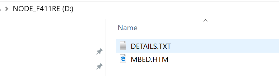

This time, when I connect the program to my computer, same storage disk (NODE_F411RE (D:)) has jumped out, however, in stead of usual two files (
DETAILS.TXT and
MBED.HTM), there is one additional file called
FAIL.TXT, and when I opened it out, it shows:
The interface firmware FAILED to reset/halt the target MCU.
I am not sure how to fixed this, if anyone can help, that would be appreciated.

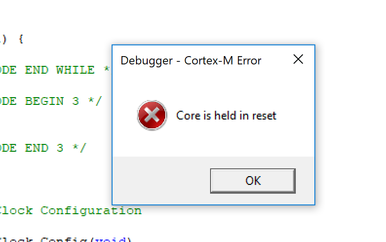

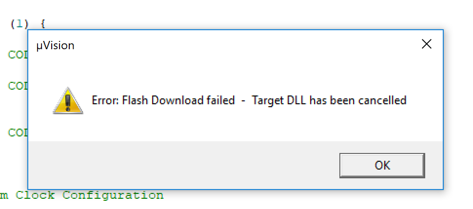

Hi Clive One, I have tried what you said today, by adding power to VDDA/VERF+, The FAIL.TXT has gone, however, when I upload code from Keil (I am using STM32Cube MX combined with Keil to program the MCU), it returned with Core is held in reset. And I am not able to upload any code.
And then I tried to add a 4.7uF capacitor between VCAP (Pin 30) and GND, as soon as added it, the FAIL.TXT Jumps out again, original problem has come up again.
Is there anything else I've missed? I will read through the document that you recommended, but if you have any suggestions, that would be great.
PS. I have checked my custom made PCB, before I connect the programmer to the PCB, the following connection has already made:
the NRST (PIN 7) of MCU is connected to GND with BOOT0 (PIN 60)
OSC_IN (PIN 5) and OSC_OUT (PIN 6) are also connected to GND
VDDA/VERF+ (Pin 13) and VBAT (Pin 1) are connected to 3.6V
VSSA/VREF- (Pin 12) is connected to 100uF capacitor and the capacitor is then connected to GND.
Thank you!

VSSA should not 'go through' the capacitor to ground, it should be at ground potential.
NRST should not be connected to ground permanently.
If you hold NRST low the device is not going to function, because you're 'Holding the Core in Reset'
