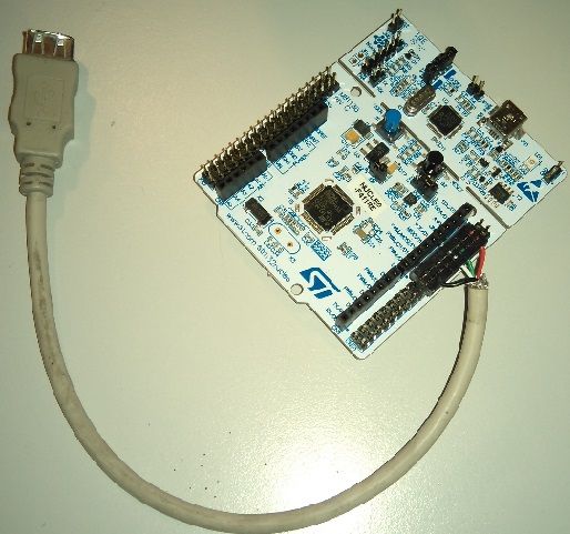

I'm using
http://www.st.com/web/en/catalog/tools/PF260320
 to manage a printer trough a usb connection. I would to be sure that my usb connection is right.
Pins connection :
 Printer side STM32 side
 Vbus 5V (red)  U5V
 D+ (green) PA12
 D- (white) PA11
 Black (gnd) GND
Is that correct ?
