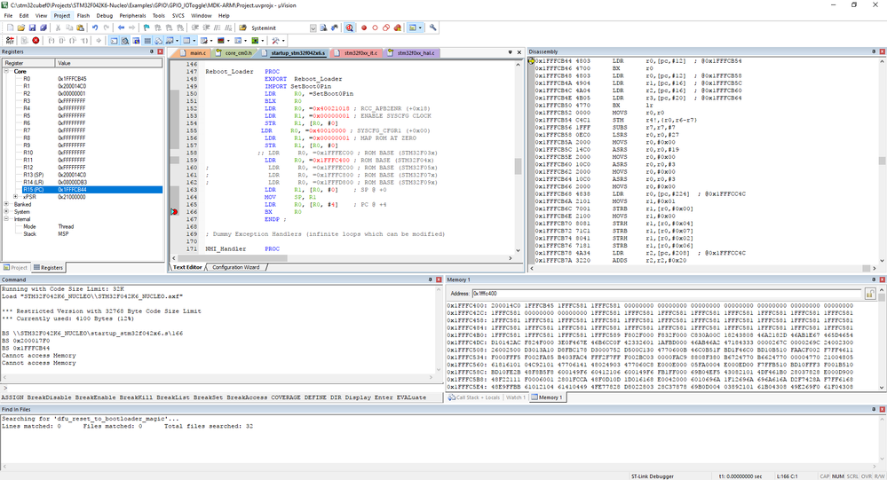

Snapshot when the code is jumped to system memory bootloader. Notice the jump to the code location 0x1FFFCB45 as per the memory window showing the value at the reset vector address.

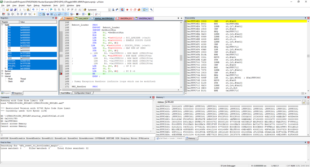

Allowed the code to run for some time. Notice the change in PC register shown in the registers window

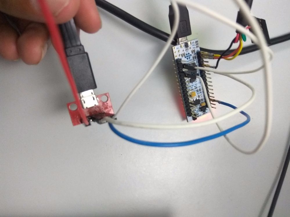

I've used a small break-out-board to takeout usb signals to the host machine. As I could not see usb enumeration happening, I've also used FTDI usb to serial cable and connected it to the nucleo board. See below for connection details.
Also I've tried using the test app that was posted in other thread to find the device is in DFU mode. That application is not receiving any data that confirms that the USB DFU is not running. Notice that it is for STM32F072 but I hope that this should work for STM32F042 as well.
/external-link.jspa?url=https%3A%2F%2Fstackoverflow.com%2Fquestions%2F28288453%2Fhow-do-you-jump-to-the-bootloader-dfu-mode-in-software-on-the-stm32-f072
The test app is not receiving any characters back from the device. Someone please guide me on what could be the problem?
