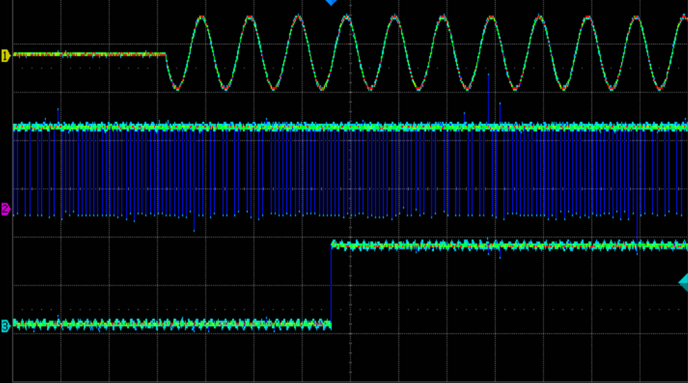

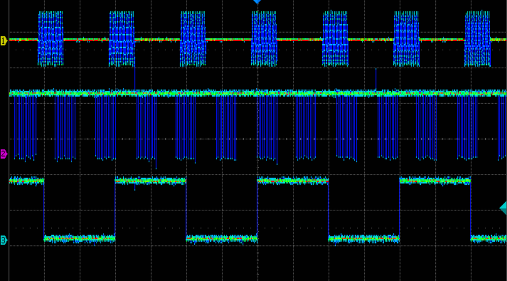

Posted on March 21, 2018 at 10:57
Hi T J, thanks for your reply.
I have tested the example code with both a sine wave and songs, and it is able to play correctly both of them.
As you suggested, I have check the optputs of my code with a scope. The following figures show the obtained results:
CH1(yellow): sine wave @1KHz;
CH2(pink): FPGA's almost full flag;
CH3(blue): this signal change polarity every time the program enters in the
HAL_SAI_Transmit_DMA function;
FIG1: 20ms/div
FIG2: 1ms/div
The main problems of these results, in my opinion, are:
1) the sine wave is periodically truncated;
2) CH3 change polarity every 40ms. However,
the
HAL_SAI_Transmit_DMA function would be called by the interrupt handler every 20ms (because USB host @48KHz produce 384byte/ms and the half buffer is
7680 byte (7680/384 = 20ms)
). So it seems like the
while (HAL_GPIO_ReadPin(GPIOB, GPIO_PIN_15) == GPIO_PIN_SET); is asserted too  often such that  the BSP_QSPI_Write function is not able to sent enough data in 20ms.
However, I have already tested both the FPGA side and the  BSP_QSPI_Write function with the SPDIF interface, which is actually working correctly.
NOTE: in the previous post, I have linked the wrong git repository. The example design I have used can be found in:
https://github.com/PaxInstruments/STM32CubeF4/tree/master/Projects/STM32446E_EVAL/Applications/USB_Device/AUDIO_Standalone
Thanks for your support.
