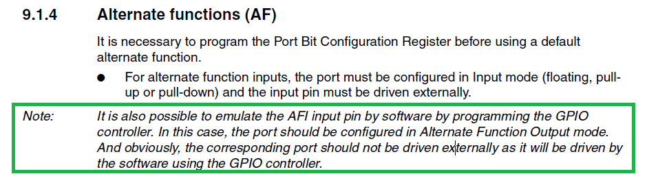

I digged into the reference manual again. Found this:
It looks like it is possible to drive the TIM3_CH1 and TIM3_CH2 pins low from within the MCU. Then I don't need to rewire all boards :)
Posted on June 15, 2013 at 02:13
That would work for an F1, the F2/3/4 less so, you'd didn't state which part you were using.

Posted on June 15, 2013 at 13:34
I use a STM32F103.
Now I have tested the XOR solution. It works :)
I set TIM3_CH1 and TIM3_CH2 low (GPIO_Mode_Out_PP).
I also tested to set TIM3_CH1high to confirm that the XOR really uses the set levels. And the duty cycla was inverted (as it should).
