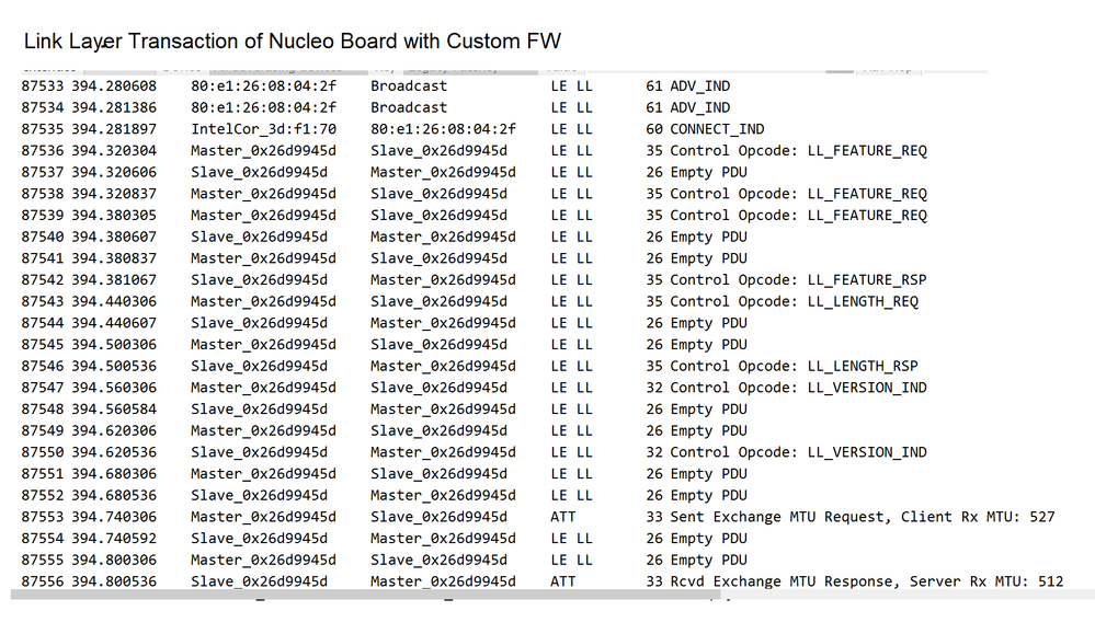

I am using an STM32WB55 IC for a BLE project on a custom board. I installed the version v1.13.3 of stm32wb5x_BLE_Stack_full_fw.bin.
I am using a Windows laptop to connect to my custom board.

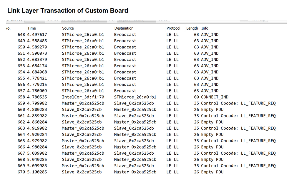

My custom board can advertise well and can intermittently connect to my Windows laptop. However, if i load my FW to a Nucleo WB55 board, I can connect to my Windows laptop consistently.

I attached the Link Layer traffic of the custom board and the Nucleo board for reference.
0693W00000QLz5mQAD.pngHoping for your suggestions and idea.
