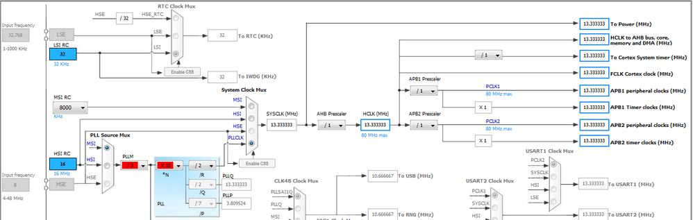

I did as you advised me but I have got fs = 2.46 Khz for DACS. But With GPIO the pin speed is 23.8 Khz. Below you have clock config
{RCC_ClkInitTypeDef Clk_init_struct;
    Clk_init_struct.ClockType =  RCC_CLOCKTYPE_HCLK|RCC_CLOCKTYPE_SYSCLK
    Clk_init_struct.SYSCLKSource =  RCC_SYSCLKSOURCE_MSI ; //RCC_SYSCLKSOURCE_PLLCLK;
    Clk_init_struct.AHBCLKDivider = RCC_SYSCLK_DIV1  ;
    Clk_init_struct.APB1CLKDivider =  RCC_HCLK_DIV1  ;
    Clk_init_struct.APB2CLKDivider = RCC_HCLK_DIV2  ;
    if (HAL_OK != HAL_RCC_ClockConfig(&Clk_init_struct, FLASH_LATENCY_2)) {
                    RCC_Error_Handler();
void OscConfig(void)
{RCC_OscInitTypeDef Osc_init_struct;
//RCC_PLLInitTypeDef PLL_init_struct;
    Osc_init_struct.OscillatorType = RCC_OSCILLATORTYPE_MSI ;
        Osc_init_struct.HSEState = RCC_HSE_OFF ;
        Osc_init_struct.HSI48State = RCC_HSI48_OFF;
        Osc_init_struct.HSICalibrationValue = RCC_HSICALIBRATION_DEFAULT ;
        Osc_init_struct.HSIState = RCC_HSI_OFF;
        Osc_init_struct.LSEState = RCC_LSE_OFF  ;
        Osc_init_struct.LSIState = RCC_LSI_OFF ;
        Osc_init_struct.MSICalibrationValue = 0;
        Osc_init_struct.MSIClockRange =RCC_MSIRANGE_7;
        Osc_init_struct.MSIState = RCC_MSI_ON ;
        Osc_init_struct.PLL.PLLState = RCC_PLL_ON;
        Osc_init_struct.PLL.PLLM =3;
        Osc_init_struct.PLL.PLLN = 10;
        Osc_init_struct.PLL.PLLP = RCC_PLLP_DIV4;
        Osc_init_struct.PLL.PLLQ = RCC_PLLQ_DIV4;
        Osc_init_struct.PLL.PLLSource =RCC_PLLSOURCE_MSI;
        Osc_init_struct.PLL.PLLR = RCC_PLLR_DIV2;
DOSS FOF

Posted on May 22, 2017 at 15:09
Here is your clock configuration. Strange !!!!
RCC_MSIRANGE_7 = 8MHz and PLLM dividor = 3. Which mean PLL input frequency is equal to 2.667MHz ?
It's not good to have PLL input frequency < 4. Range should be 4 to 16MHz (look into Datasheet > Electrical Charac > PLL)
With PLL config, SYSCLK = 13.333MHz
Not easy to have correct Timer interrupt with this settings !
I suggest you study the datasheet and reference manual before.
