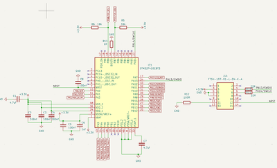

Hello, im using STM32f410CBT3 on custom board. I was able to debug before, but now Im getting errors trying to conect to STM32 using stlink v3 set with isolation. Sometimes i can read data, but it is corrupted (all 0, but i didnt flashed it yet). Tried replacing CPU, but it didnt work. The nRST is conected with capasitor to gnd and i tried adding pull up with 10k (this cpu has pull up inside).

When measuring voltage on Nrst, it shows 0,6 V. I gues it is floating, but why...

Show the salient parts of the schematic for this custom board.
Do you have Analogue VDD/VSS connected? VDDA / VSSA needed regardless of ADC/DAC usage
Check chip orientation
Check 1.25V at VCAP pins, 2u2 F on each, or 4u7 F on connected?

Nothing is jumping out on the design.

Check board for shorts, check net-list for missing or unanticipated connectivity of nets.
