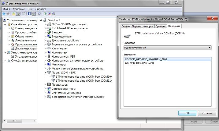

But in device manager, i have these devices:
So, drivers is installed, but it's not work. One interesting detail - in error PID = 5741, but in dev manager PID = 5740.

    Rather than Device Manager, perhaps checking with RegEdit might be more constructive.
    If the keys it is looking for do not exist you will clearly have problems, and you will need to contact your local ST representative, or FAE, as ST support has practically no presence on this forum.
    If it has problems with the registry, check the rights your user has to access this portion of the registry tree, and whether the non-English install of Windows is causing naming issue.
    You might also want to confirm your user has Admin Rights, or run the applications ''As Admin''
