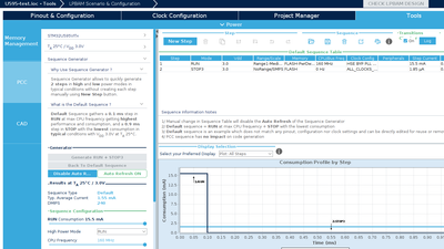

I am reaching out to request assistance with the power budget calculation for the STM32U5A5QJI6Q microcontroller.
Specifically, I would appreciate it if you could provide a detailed breakdown of the power consumption under various operating conditions, including active mode, sleep mode, and any other relevant modes.
How to calculate power budget?

in IDE/CubeMx is also a power calculator: set what you want and make a some ms step - then you see...
-> New Step -> then set your peripherals , that you use ...

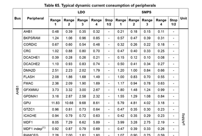

without IDE/CubeMx is possible to calculate using formula, have any example?
Regards
Sakthi
So look in ds and add all together + cpu ... but why not using Cube ? Too easy ?
see ds ...4 pages !!!!
