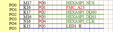

I'm using the STM32N657 processor and have the HEXASPI device running at 1.8V.
VDDIO2 is connected to 1V8 supply (which affects: PO[5..0] and PP[15..0]
The FMC is placing the A23 line on pin PO1 (this is the only option for the FMC-A23) and the FMC device is running at 3.3V.   Can I place a pullup to 3.3V on PO1, or will this affect/blow  the GPIO connected to 1.8V -OR- do I need to place a voltage translator on that pin?

matt-crc
Senior III
Hi @RomainR.
1- yes it is the VBGA264    STM32N657X0H3Q
2- FMC-A23 is not available on A14-PD1, F13-PB3, or T17-PN2.  I attached the .ioc file if you wanted to see it.
3- I want to run the FMC at 200MHz with the address setup time = 1 cycle.  I'm not sure if a voltage converter will skew address decoding (if that is the only address line going to a voltage translator).
At this point, I'm debating if i should just remove A23 all together from the design... sigh
4- Can you confirm that on the N657, the FMC can run at 200MHz?  All I found in the reference manual was a transfer rate of 800Mbytes/sec on the FMC.
thanks, Matt

Hi @matt-crc
You have assigned PB3 and PD1 for other FMC signals in your .ioc (FMC_A7 and MC_FBL1)
This is why you cannot use them for FMC_A23.
But it is available in AF14 as explained in Table 20. Alternate functions: AF8 to AF15
The FMC timing can be found in DS14791 Rev7 in 5.3.19 FMC characteristics where all timing
are based on Tfmc_ker_ck = fmc_ker_ck
If you refer to RM0486 in Table 73. Peripheral clock distribution summary (continued) indicates
max kernel clock FMC = 200MHz
You already use the biggest package. You must choose between XSPI or FMC, both seem not a possible use case.
