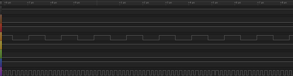

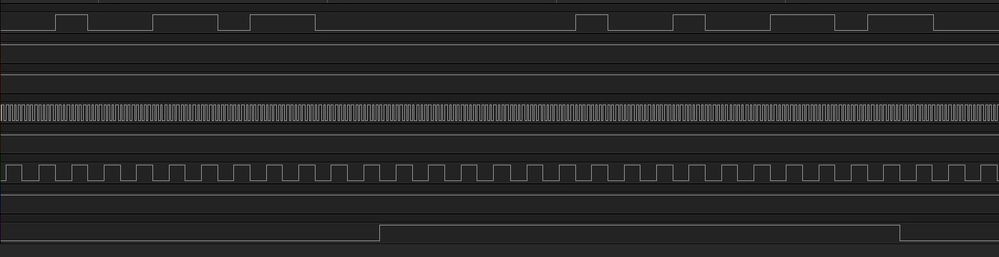

delphi
Posted on July 19, 2016 at 20:12
I attached 2 files.
In non working example with SAI2 you can see only MCLK and SCK.
Another signals seems to be no (logic one everwhere).
But in another picture with standard example everything is ok0690X00000602bmQAA.jpg0690X00000602brQAA.jpg
delphi
Posted on July 20, 2016 at 08:24
Logic one - for I2C and reset - this is normal
But other important lines are zero!
delphi
Posted on July 21, 2016 at 09:51
Sorry. In the first message I gave an incorrect info about block B of SAI1. It is not working too with the same thing described in picture! You can see only near 700KHz bit clock signal and 6 Mhz input clock signal for codec. Codec init was succes on I2C but then the same situation is here too.0690X00000602bwQAA.jpg

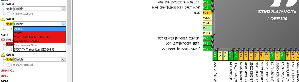

Posted on July 21, 2016 at 10:12
I also cann't understand why I cann't choose the block B in cubeMX software to choose the master mode with clock output?0690X00000602cBQAQ.jpg
delphi
Posted on July 21, 2016 at 10:54
To solve this problem I am downloading the cube mx and it is clear for me now that there is one feature not clear describe in docs. You must shoose the another dma channel. For B block - the 2nd or 7th of DMA2
