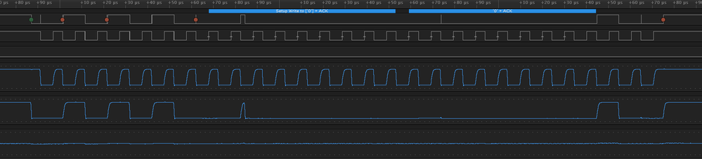

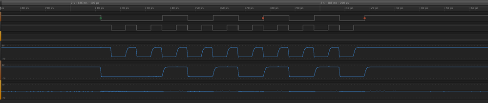

I recently brought up the I2C using the STM32CubeMx(4.0) and STM32CUBE_FW_L4_v1.6.0 and I was attempting to write to a slave device with an address of 0x2A.
I noticed that my slave device was NACK-ing back. Upon further inspection, it looks as if the address is shifted to the right by 1-bit, resulting in an address of 0x15 when transmitted on the line.
To test this theory out, I purposefully used an address that is shifted 1-bit to the left: 0x Doing so registered an address of 0x2A on the physical bus which then I was able to hit the register with some data.
I couldn't find any literature that required me to shift my I2C address left by 1-bit to have it address correctly. Has anyone else run into this issue?
My solution is a work around but I would like to understand the root cause of this issue; whether I introduced it or possibly an inherent issue with the HAL drivers?
Thanks!!

Output Using Slave Address 0x54:
Output Using Slave Address 0x2A:

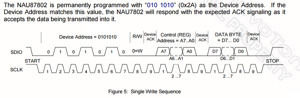

Datasheet I2C Output:

Posted on February 24, 2017 at 17:24
I'm not exactly too sure if it is an issue with the address as providing it a larger address will still result in the same location within the register. See snippet of the datasheet below.
I took a deeper dive to see where the slave address is being stored against the datasheets register. On the surface, the value at the register seems correct in both instances; 0x2A and 0x

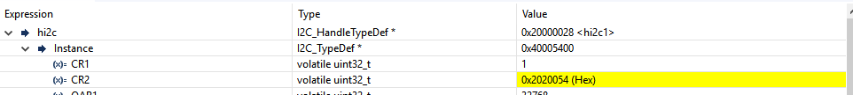

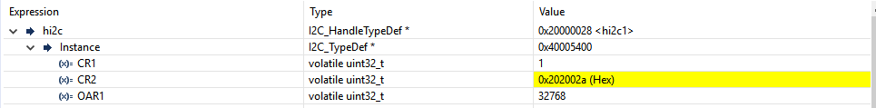

In the instance of writing 0x2A, the register value is 0x202002A:
In the instance of writing 0x54, the register value is 0x2020054:
These values line up with the register content located in the datasheet (DocID027294 Rev 2):

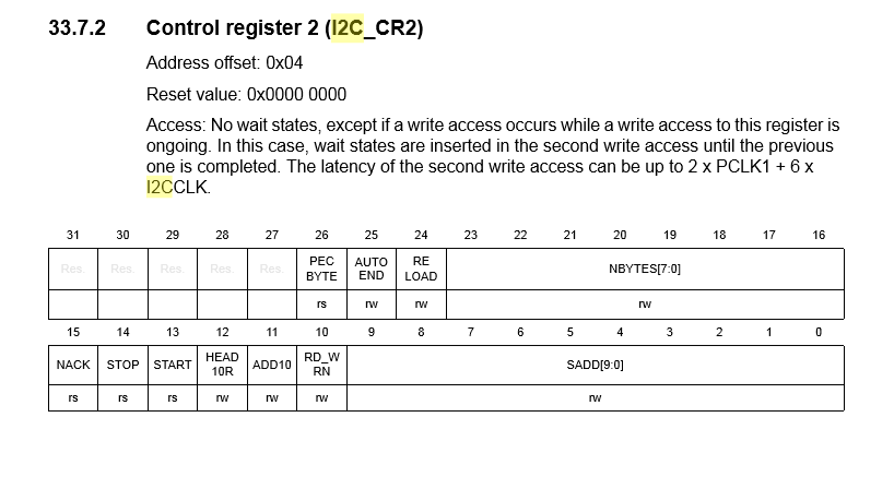

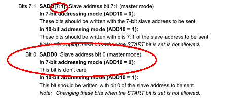

Posted on February 24, 2017 at 18:26
Read also the description of I2C_CR2:
Posted on February 26, 2017 at 05:12
Yep. You are absolutely correct. Solved my issue and now I am transmitting and receiving just fine. I wish somewhere within the HAL comments explicitly mentioned this.
