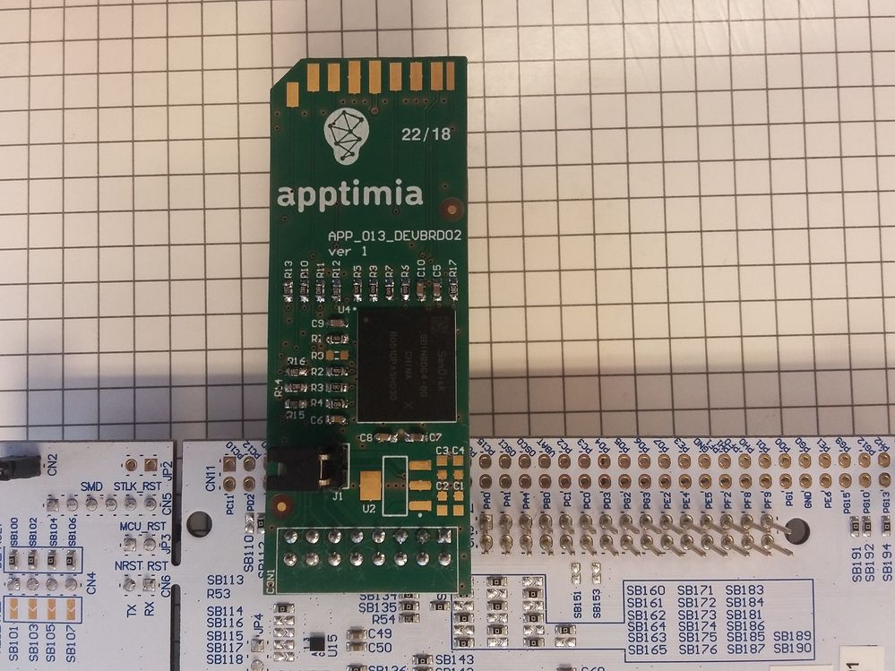

Posted on July 05, 2018 at 23:07
I have these board from
Przenioslo.Lukasz
I'm currently working on the same boards and I was looking forward to make eMMC work with it.
Do you manage to make it work ?
Yes, I have working eMMC support ported to multiple STM32 platforms.
Do you bother to send me an exemple of your code ?
I tried to port F4 HAL MMC file to L4 but it didn't work at first try.
I would really appreciate a little bit of help :)
thanks
Which board specifically, I mentioned two? Four or Eight bit implementation?
Which makes/models of eMMC are you using?
I can provide a demo application in .HEX format, source code is only available to clients. Contact details in profile.
I think this is a reasonably current 4-bit eMMC build for the NUCLEO-L4R5ZI
Outputs diagnostic via ST-LINK VCP at 115200 8N1
