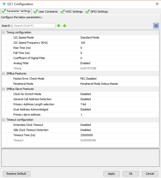

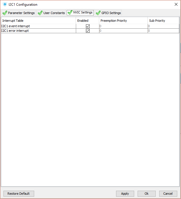

I changed a couple of things in the configurations (screenshots below) and changed the code to the following:
return_value = HAL_SMBUS_Master_Transmit_IT(&hsmbus1,MLX90614_ADDRESS,(uint8_t*)MLX90614_TA,1,SMBUS_FIRST_FRAME);
while(HAL_SMBUS_GetState(&hsmbus1) != HAL_SMBUS_STATE_READY);
if (return_value != HAL_OK)
   return return_value;
return_value = HAL_SMBUS_Master_Receive_IT(&hsmbus1,MLX90614_ADDRESS,(uint8_t*)data_read,2,SMBUS_OTHER_AND_LAST_FRAME_NO_PEC);
if(return_value != HAL_OK)
Right now I can read values from the sensor but they don't seem to be correct.
Any help?

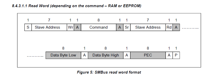

My sensor is now working! Here's the code:
char buffer[5];
float temperature;
int main(void){
while (1)
HAL_I2C_Mem_Read(&hi2c1, 0x5A<<1, 0x07, 1, buffer, 2, 100);
 int_temp = (buffer[1] <<8 | buffer[0]);
  temperature = int_temp*0.02 - 273.15;
  HAL_Delay(200);
Since the sensor needs a repeated start, HAL_I2C_MEM_Read() will do the job for you! Because of the stop-condition, which is set by HAL_I2C_Master_Transmit and HAL_I2C_Master_Receive you wouldn't be able to read the values properly because of that missing repeated start. Mem_Read on the other hand does the following: start, I2C address + Write, Memory address, repeated start, I2C address + Read, N bytes, stop. Besides that when combining the two data bytes you have to pay attention that the lsbyte (in my example buffer[0]) comes first, so you have to shift the msbyte by 8 and "OR" it with lsbyte. After that you'll get proper temperature-values.
Hope this will help other people, struggling with this sensor.
Artem
So you are running the sensor in I2C mode instead of SMBus?
Artem
Ok, got it working in standard I2C mode. Thank you!
