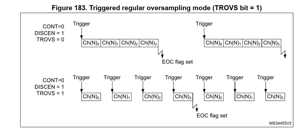

I am planning to use STM32L4 hardware oversampling by a factor of 2.
With the current setup (without oversampling), I am triggering ADC capture and conversion using Timer update event. The timer update event is generated at 10kHz and so the ADC is sampling at 10kHz. I am using DMA transfer from the ADC to fill buffer array of 1024 length and call ADC conversion complete interrupt.
Now, with a oversampling period of 2, what will be the total sampling period to capture 1024 data points?
Ex. With current setup, total time to capture 1024 samples = (1/10 kHz) x 1024 = 102.4 ms.
With the oversampling hardware configured (Factor 2) with the same timer trigger of 10kHz , will the total time to capture 1024 samples increase by a factor of 2? i.e 204.8ms?

AScha.3
yes. basic timing stay same. only data is average of 2 or more sampels, with better resolution (should have...).
(as i understand it...) exept you use a mode to trigger every conversion:
0693W00000aInWGQA0.pngbut if you make sampling time very long - yes, then you could control sampel rate this way.
just - more "usual" way would be : set sampling rate by a timer, triggers ADC. then with short adc-sampling-time you get always same clear defined sample frequency, just more resolution with oversampling. (observe time needed for all the sampels when ov .)
