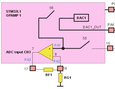

Hello All,
I connected DAC1 output (S6 closed, S5 opened) to the internal OPAMP1 AIN+ which is in noninvering configuration by two external resistors (Rf=150k, Rg (to ground)=50k) which should yeld G=x4 amplification. When I change DAC output (Uin) from0 - 0,5V I get on the OPAMP1 ouput (ADC Input Channel 3), Vout : Uin=0,5V -> Vout=2,035V which is ca. G=4,0 Uin=0,2V -> Vout=0,853V which is ca. G=4,2 Uin=0,1V -> Vout=0,450V which is ca. G=4,5 Uin=0,025V -> Vout=0,157V which is ca. G=6,2 !!!! The lower the Uin to the opamp AIN+ the greater the OPAMP Gain error. These are my configs:

What could be the reason for this error? thanks in advance Tom #stm32l-opamp-gain-error

This is the internal schematic I use:
