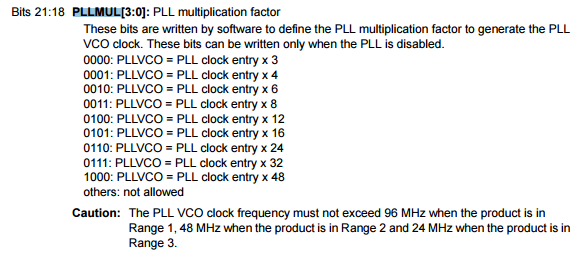

As a noob, I need to know whether there is a 96MHz mode as the documentation sugests
C:\Users\PD\STM32Cube\Repository\STM32Cube_FW_L0_V1.7.0\Drivers\STM32L0xx_HAL_Driver\Src\stm32l0xx_ll_utils.c
void LL_SetSystemCoreClock(uint32_t HCLKFrequency)
  * @brief  This function configures system clock with HSI as clock source of the PLL
  * @note   The application need to ensure that PLL is disabled.
  * @note   Function is based on the following formula:
  *         - PLL output frequency = ((HSI frequency * PLLMul) / PLLDiv)
  *         - PLLMul: The application software must set correctly the PLL multiplication factor to avoid exceeding
  *           - 96 MHz as PLLVCO when the product is in range 1,
  *           - 48 MHz as PLLVCO when the product is in range 2,
  *           - 24 MHz when the product is in range 3
UM1749  User Manual
Description of STM32L0 HAL and Low-layer drivers
1352/1438 DOCID026232 Rev 5
LL_PLL_ConfigSystemClock_HSI
Notes
Function is based on the following formula: PLL output
frequency = ((HSI frequency * PLLMul) / PLLDiv)PLLMul: The
factor to avoid exceeding 96 MHz as PLLVCO when the
product is in range 1,48 MHz as PLLVCO when the product is
in range 2,24 MHz when the product is in range 3
FLASH latency can be modified through this function.

Yes it seems that these are typos on the user manual UM1749 document.
The maximum frequency on STM32L0x is 32 MHz. Make always the Reference manual and datasheet, the first sources of information.

1- to know the maximum ystem clock frequency, you have to refer to the datasheet of your product (General Operating Conditions). It is 32 MHz
2- In UM1749 as well as drivers in the Cube package, the 96 MHz is the maximum PLLVCO clock frequency. It is related to the configuration of PLLMUL as described in the reference manual:
-Amel-
