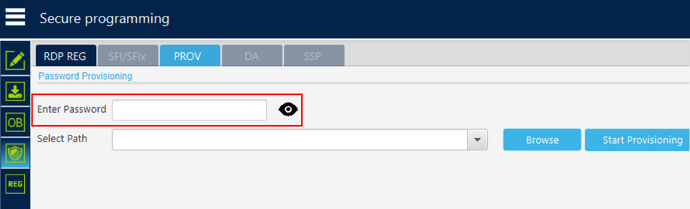

Hello, I am asking for help from the community. My application is completely written, but I can't set read protection. I tried to do all the steps in this guide, but it led to bricking one of my boards. The second board is still in product state = 17? but I can't install the obk file or remove protection, returning it to the ED state. Cube programmer did not give me the choice "Change the PRODUCT_STATE option to 17, then press [Apply]. A window appears asking if the default DA-Config should be applied, press [NO]." it just set the state to 17 without asking.
I did not find any sensible information on the network on how to set or remove protection. Maybe it is possible to do this directly from the application? in state 17 I can flash h503, but I can't switch to debugging.
I really ask for help, my project is completely ready, but it needs to be protected.

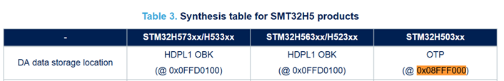

The key is written to h503 in the OTP memory, at the address 0x08FFF000 (specify this address in DA_ConfigWithPassword.xml in the file in the <ObDestAddress> field when preparing the password), so it must be clean and never written before.

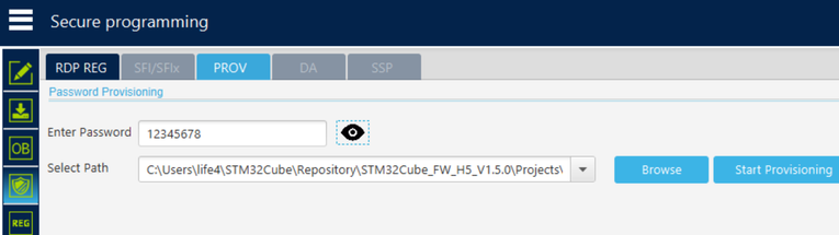

<Value>12345678</Value> - set the password
then save the xml file and standardize the OBK file and password.bin files in STM32TrustedPackageCreator.
then in the Cube Programmer, PROV tab, in the Enter Password field, you enter your password, and in the Select Path field, specify the path where the generated OBK file is located and click Start Provisioning.

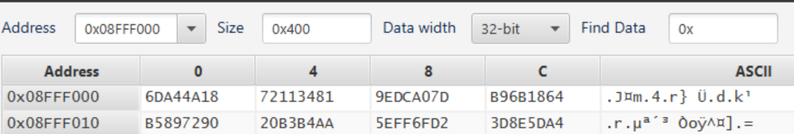

You can program a password into the processor in the ED or 17 state, it makes no difference. After programming, you can view the encrypted password at 0x08FFF000.

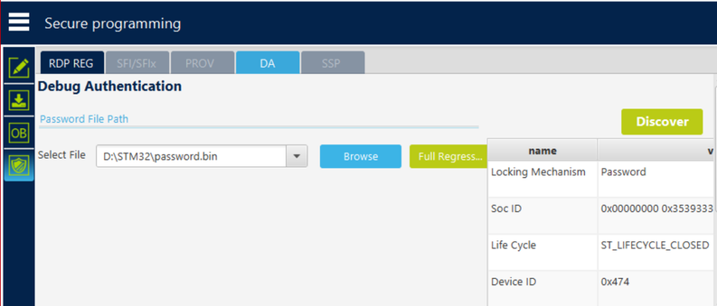

1- the processor reset pin MUST be connected to the RESET stlink pin, otherwise you will not be able to remove the protection.
2- without pressing connect, go to the Secure Programming tab, open the DA tab, press the Disk button there and a description of the state of your processor and its ID will appear.
3- press Full regression
4- done, you have set the password, set and removed the protection.
