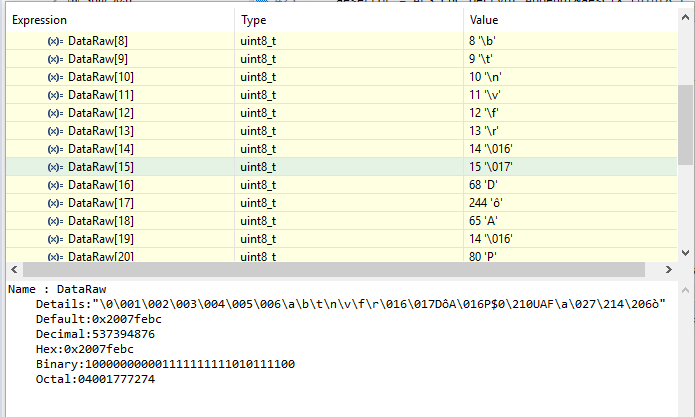

Using AES 256 in CBC mode attempting to encrypt block of data on the Host which is the PC, and decrypt that same block on the MCU using the CryptoLib. Encryption on host is done correctly, decryption of the first block of data is done correctly on the MCU, but decryption of the second block of data fails(Bytes 16-31). Below is my test code.

aeserror = AES_CBC_Decrypt_Finish(&aesCTX,(uint8_t*)DataRaw,&aesoutputsize);The decryption only works for the first 16 bytes, fails for the next 16 bytes. The following website shows what the decryption should be

.This is what i get when i run it.
Which is wrong since the plaintext goes from 0-31.
Anyone know what im doing wrong?

Encryption on host is done correctly, ...
I'm not convinced, show how you did it.
Your input data is flawed, using entirely different AES-256 code I get
0000 : 00 01 02 03 04 05 06 07-08 09 0A 0B 0C 0D 0E 0F ................
0010 : 44 F4 41 0E 50 24 30 88-55 41 46 07 17 8C 86 F2 D.A.P$0.UAF.....Up vote any posts that you find helpful, it shows what's working..

CRC32 6ED981750000 : 00 01 02 03 04 05 06 07-08 09 0A 0B 0C 0D 0E 0F ................0010 : 10 11 12 13 14 15 16 17-18 19 1A 1B 1C 1D 1E 1F ................My guess is that your encryption code is miss applying the IV and that feeds through

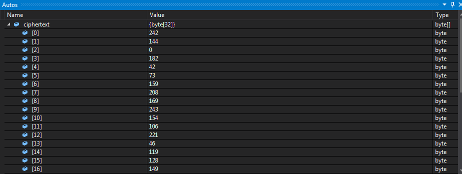

I have studied the CBC mode and why IV is needed. The keys and values im using arent random so i can see it work.
Encryption was done in C# and since the first 16 bytes were decrypted correctly that must mean the rest were also encrypted correctly. Also this(
/external-link.jspa?url=http%3A%2F%2Faes.online-domain-tools.com%2Flink%2Feea909ghxsatKRjSA%2F
) site is an online AES decryptor and when i feed in those keys with the ciphertext i get exactly what i expect as the decrypted data. This leads me to believe the issue is somehow on the MCU decryption side.If you want to try replicate what im doing here is the C# code:
AesManaged myAes = new AesManaged();
byte[] IV = new byte[16];
byte[] key = new byte[32]; byte[] plaintext = new byte[32]; byte[] ciphertext = new byte[32];for(int i = 0; i < 32; i++)
{ key[i] = (byte)i; plaintext[i] = (byte)i; if(i < 16) { IV[i] = (byte)i; } }myAes.Mode = CipherMode.CBC;
myAes.IV = IV; myAes.Key = key; myAes.Padding = PaddingMode.None;// Create a encryption object to perform the stream transform.
ICryptoTransform encryptor = myAes.CreateEncryptor(); encryptor.TransformBlock(plaintext, 0, 32, ciphertext, 0);And hereare the values of the ciphertext at the end of executing the above:

DataEncrypted[18] = 187; // This should be 184
‎2017-10-12 11:11 PM
Wow, such a dumb mistake on my part. Thanks
