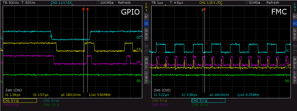

I want to connect a TFT with SSD1963 Controller to a Nucleo-144 F746ZGT. If i use GPIO lines to send data to the SSD1963, everything works fine. I choose the same GPIO Pins as if I would use the FMC so i do not need different Hardware, I only Change the initialisation of the used Pins. With GPIO Pin toggling, Speed is not satifying.
So i activate the FMC, but the Timings do not fit to the Needs of the SSD1963. The CS should rise before WR/RD and D/C like during GPIO mode. But as you can see CS rises at the same time as WR and D/C .

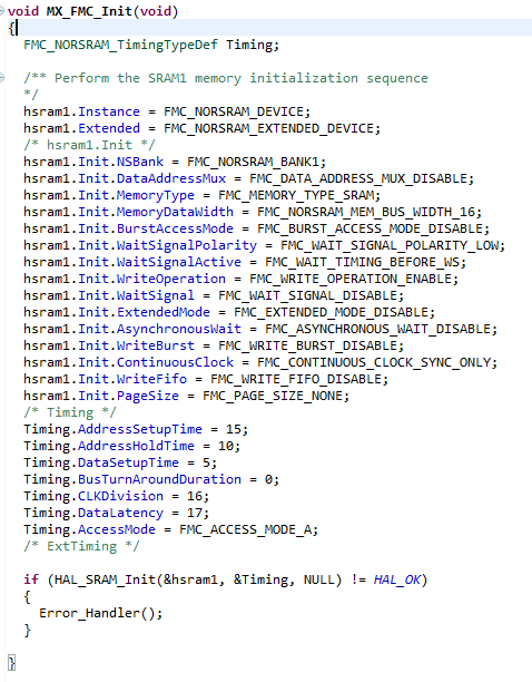

These are the Settings for FMC. How can I adjust the Timings to get a waveform with an early CS ? Can it be done just with Software or do i Need external Hardware ? Checked several documents (DM00166116 page 172, STM32F746 datasheet, AN2784, AN2790), but did not get a clue.

I have looked into this before, from memory, the /CS pin does come up 1nS before /OE or /WR
the SS1963 will probably run 20x faster than your image..

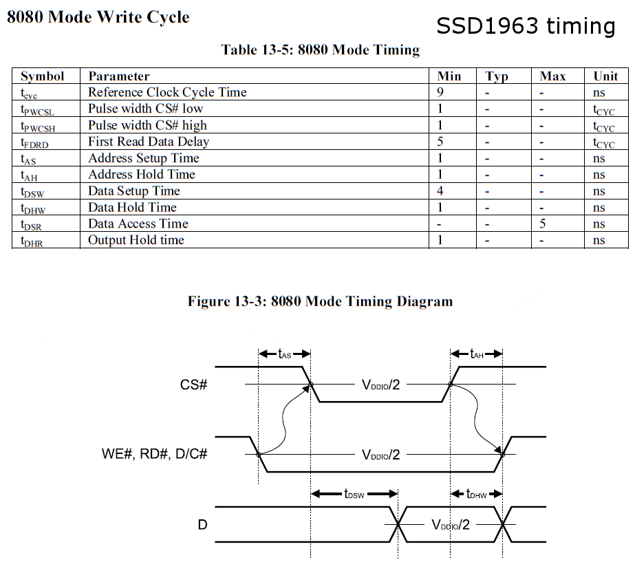

table 88 shows read timing , /OE after /CS Tv(NOE-NE) ... 0nS min -1nS Max...
table 90 show the write timing , /WE is THclk +1nS after /CS Tv (NWE-NE)
THclk is 1/216MHz 4-5nS
but I haven't tried it yet..

verfied my FMC Settings with my oscilloscope, so I noticed that there is almost no delay between
CS, WR and DC no matter which FMC Settings i tried. And the 0.5ns is a jitter which occur to all
signals , not a promised Timing value.
The SSD1963 Needs a delay of at least 1ns - tAH.
