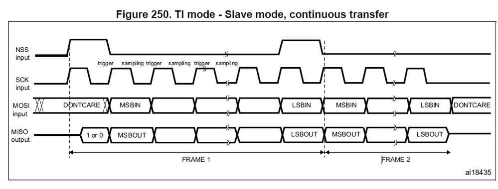

On datasheet of STM32F745, fig. 46, and fig 47 (pag 157 & 158) for slave configuration show that NSS input toggle to low level for a frame. For master configuration, fig. 48, it seems that not toggle. However, I have tested these signals on a NUCLEO-F439 board and it seems that NSS toggle. Please find attached pictures that I have taken in a 60Mhz oscilloscope. They corresponde to the NSS signal and SCLK (f 42MHz). One is in a "full master" configuration and the other one as "only receive Master". In both cases NSS is gneerated and hold low for the full frame.
So, are you sure that NSS is not toggling? What am I missing?

In regular mode, NSS doesn't toggle. In TI mode, a pulse on NSS is output one clock before the MSB. TI mode is not commonly used, but it may work for you here. You would need to increase the frame size by 1 bit and ignore the data coming in when NSS is high. See "TI mode" in the reference manual.
I'm going to assume the bad rise/fall time in your signals is due to the scope bandwidth/issues and isn't present on your actual board.

I think NSS signal also toggle with Motorola mode...see Fig.371 of the Reference Manual RM0385.
So, in my opinion, STM32F745 SPI port is fully compatible with AD7274, without major difficulties.
Thanks again for you support.
Hmm. Maybe that’s the “NSS Pulse�? setting or something. Apologies for the misinformation, but glad it’ll work out. I’ll have to check that out again at some point.
