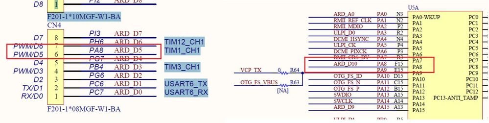

hi all
I want to run MCO1 clock output. (PA8) I tried the hal_rcc_mcoconfig function. But I could not run.I can't see any signal with oscilloscope. This is MCO settings code
HAL_RCC_MCOConfig(RCC_MCO1,RCC_MCO1SOURCE_PLLCLK,RCC_MCO_DIV4);
PLLCLK=216Mhz, MCO Div 4 Output = 216 / 4 = 54 MCO output should be 54Mhz What is the problem? Thanks

Posted on February 05, 2016 at 08:57
Hi Syrine
I resolved the problem. I found a problem with the STM32F7 Discovery scheme.
Please see the image.
PA8 pin seems to depend Arduino D5. (Schematic Page 6)  But in reality, it is depending on Arduino D10. (Schematic Page 9)
I think there's a mistake.
matthew239955_stm1_st
Posted on February 07, 2016 at 12:13
Brilliant thanks - just switched to D10 and all good.
