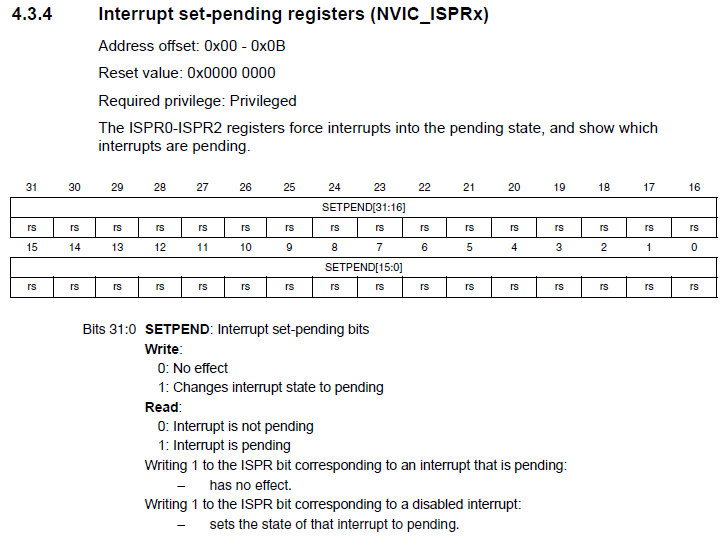

When is the ISPR register used?
ISPR [0] | = 0x00000001 << 6;
// (EXTI0 Position)
Does this code convert the EXTI0 interrupt into the pending state so that the EXTI0 interrupt should not be executed?
But the interrupts work well
Did I misunderstand?

  NVIC->ISPR[0] = 0x00000001<<6;
The exceptions can be Active , Inactive or Pending.
 Inactive means no Pending and no Active
 Pending means, the exception is waiting to be serviced by the MCU.  A SW or HW IRQ can change the state of the corresponding exception to pending. Also ISPR can change an inactive exception to pending.
Active means, an exception that is being serviced by the MCU but has not completed yet.
