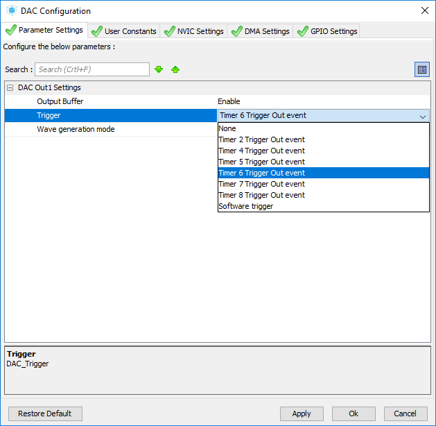

Posted on September 24, 2017 at 20:39
Clive One wrote:
>>Is this a requirement? I thought any event providing timer can trigger any DMA stream. At least that is what CubeMX allows.
Last time I looked at the matrix it was constraining..
Sorry, I completely and totally botched the question. I meant to write that any event producing timer can be used to trigger a DMA-enabled peripheral (such as DAC, see below), not that any timer could directly trigger any DMA stream.
