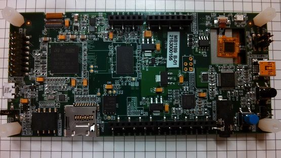

Back view

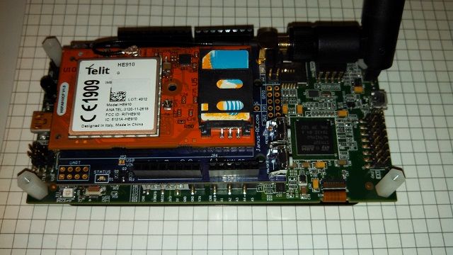

With Cellular Modem

Posted on October 15, 2015 at 22:00
http://www.st.com/web/catalog/tools/FM116/CL1620/SC959/SS1532/LN1848/PF262395?s_searchtype=partnumber
Back view
With Cellular Modem

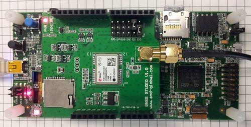

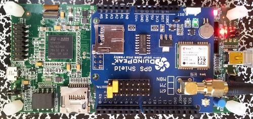

Posted on October 22, 2015 at 22:58
Arduino shield connector works well. D0 USART6_RX PG9, D1 USART6_TX PG14
LEDs at PG6, PD4, PD5, PK3
Here with a GPS shield
Need to port my CORS-LITE RINEX file recorder over to the board, and add a graphical interface with the display.
Added SDRAM initialization code, 32-bit wide, tested 16MB
