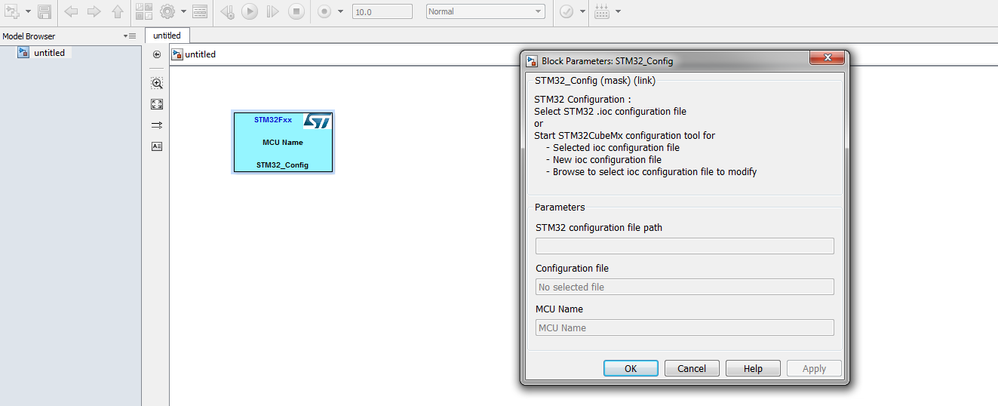

hello every one I'm trying  to program stm32f429 with Simulink and I use matlab 2013a and MAT target 4.2.0 when I have used stm_Config block to configure  hardware target I got a problem that I can’t set the block parameters 0690X00000604skQAA.png

Hi hammad.abdelazez,
R2013a Matlab version is not managing Tabs and Buttons. Please, update MATLAB version.
Model parmaeter window for STM32_config should be as following:
-Shahrzad-

, but what is the matlab version do I need ?
R2013b Matlab version is the adequate one. It is mentioned in Release Notes that:
''The mask editor is enhanced to support designing mask dialogs using controls such as images, links, and buttons...''
