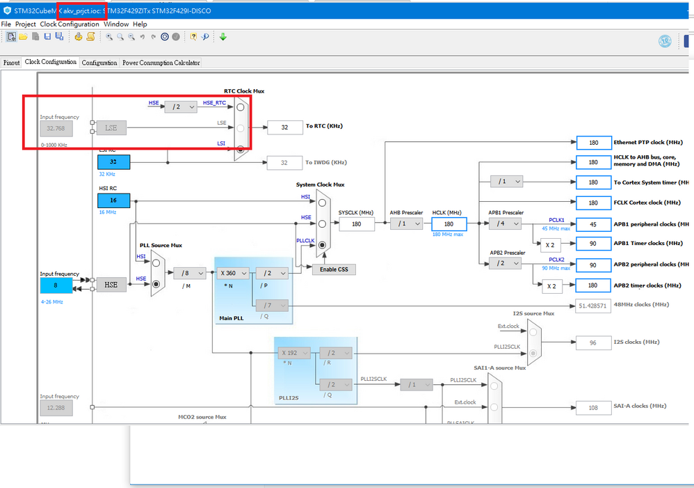

I have a problem with rtc.
When I use LSI with RTC everything ok.
But when I select LSE, program stuct at void _Error_Handler.
The problem is at this function.
while((hrtc->Instance->ISR & RTC_ISR_INITF) == (uint32_t)RESET)
   if((HAL_GetTick() - tickstart ) > RTC_TIMEOUT_VALUE)
      return HAL_TIMEOUT;
I changed RTC_TIMEOUT_VALUE 1000 to 9000 but still not OK.
How can I solve this problem ?
I use stm32f429i discovery board (I had already soldered 32.762khz xtall) and
my .ioc file at link, and  I use cubemx ver 4.21.0 and keil.

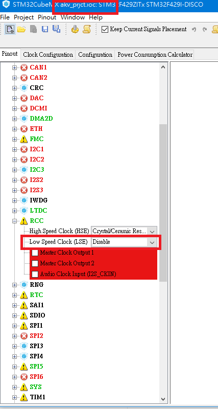

Uhm.......I just open your ioc project.
It seems that you didn't even enable the LSE, dude!
So you wan to  'cubeMX' or not?
