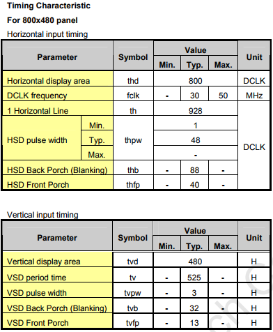

From datasheet we understand that minimum DCLK is 28 MHz. So we are setting the DCLK as 28 MHz and calculated the parameters for LTDC which are as follows.
From Datasheet
HSYNC Width
20
VSYNC Width
3
HBP
46
VBP
23
Active Width
800
Active Height
480
BVBP
23
HFP
210
VFP
22
Calculated Value for LTDC Register
HSW
19
VSH
2
AHBP
65
AVBP
25
AAW
865
AAH
505
TOTAL W
1075
TOTAL H
527
Issue :
  1. We are find Tearing Effect in the display and the same time if we probe we could find FIFO underrun issue. Please let us know the above setting as correct for 28 MHz DCLK.
  2. When we reduce the DCLK to 24 MHz the display is stable but we are facing flicker issue.
Is there any solution for the above problems without using multi buffer support. Also could you send  sample source running on any RTOS for reference

While I'm getting data in norflash, LCD have prolems is flickering.
I know that LTDC will gennerate data to LCD automatically after SDRAM refresh, isn't it?
What is solution to hold data on LTDC while other device use bus data of SDRAM (16 bit data)?
Can you tell me solutions to fix that bug, please?
Thank you so much!

I'm facing the same problem with below information
  • STM32H7 MCU platform
  • Embedded wizard for GUI development, LTDC support of course
  • TFT LCD with DCLK (26.4 MHz min, 33.3 MHz Typ., 46.8 MHz max)
  • System clock configuration: 400MHz
  • SDRAM clock configuration: 100MHz
Tearing effect in TFT LCD also occur.
I'm very appreciate if you help me to solve it
Thanks and best regards
So what rate are you clocking the display?
How wide is you SDRAM interface?
Understand H7 quite a different beast that F429I.​
==> 33MHz.
==> 32 bit
For more information, I already config Pixel clock and timings configuration as TFT LCD specification but it does not work.
Exact same display, I'm assuming.
Under what circumstances is display tearing? All the time, when image static, when you are accessing SDRAM concurrently? What are caching and MPU settings for memory regions?​
Display tearing occur when I display a background (800x400) image with rich gradient.
