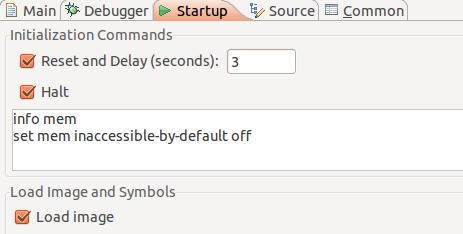

I have been using a quick and dirty solution to view the external memory in my gdb debugger now. Those who compile and debug their STM32F4 MCU in Linux Eclipse based gcc environment, can follow the steps below:
- In Eclipse IDE open Debug Configurations under Run menu.
- Select your debugging configuration under ''GDB Hardware Debugging''
- Select Startup configuration on the right pane and enter the following commands :
info mem
set mem inaccessible-by-default off
- Save your changes and now you can access to those memory spaces which the target doesn't define them explicitly for the gdb..
The first line (info mem) prints out the mem view of the gdb at the start of the debug session (output in the gdb console).
Here is the snapshot of the gdb traces when info mem and set mem ... commands are run:
