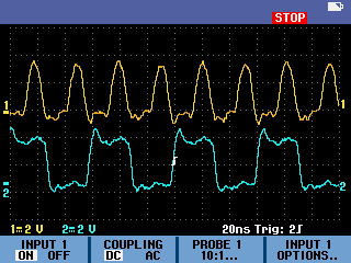

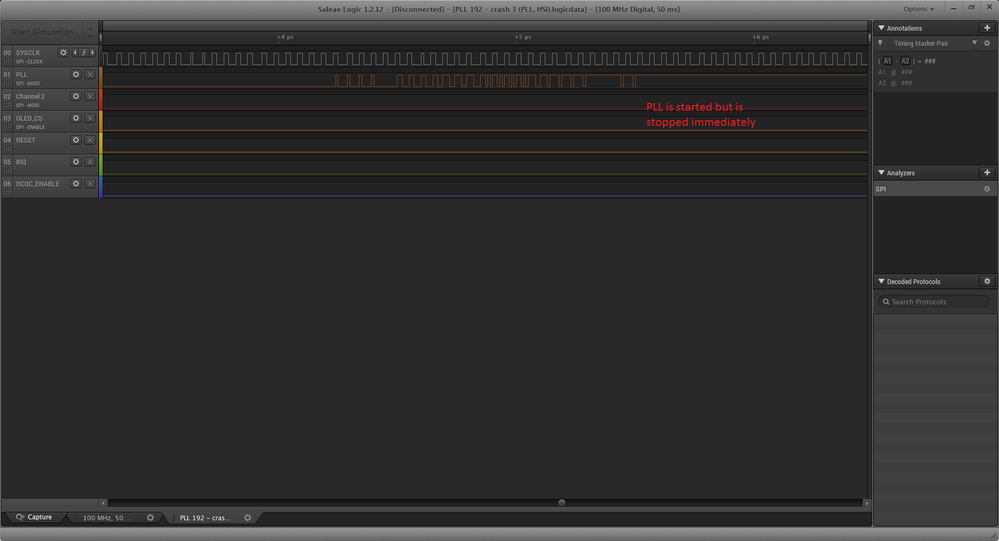

nicolas b
Posted on May 04, 2018 at 09:54
We tested the MCO pins. Clock frequencies seem normals.
We noticed that sometimes the PLL clock stopped. But we do not know if it is the micro which crashes and stop the PLL or the PLL which stops and crash the micro.
MCO pins:
