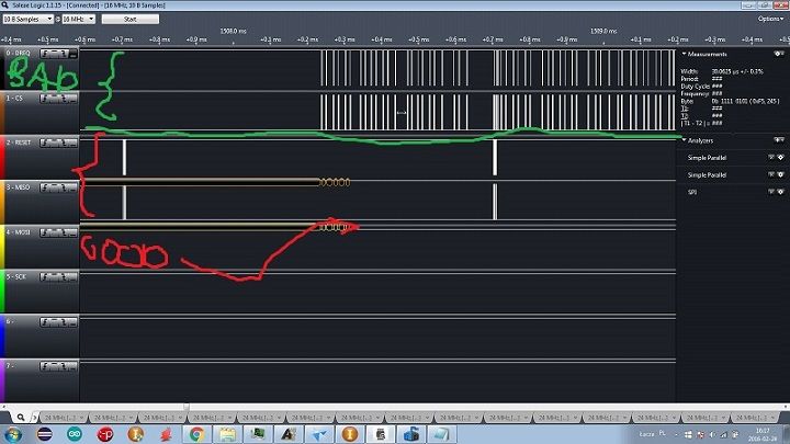

I have a strange problem with the mass storage usb on stm32407ZGt6. Why is it odd ? That's because the same code works on stm32f407ZEt6 just fine. I thought that these cpu's differ only in the amount of flash memory, but clearly there is something else. I have checked the following things:
-CPU clocks ( the registers are the same in both cpu's)
-The voltage ( I added extra capacitors)
-the crystal - 16 mhz working well
-electrical connections
-D+ D- are not swapped or anything like this, the 1,5 k resistor on D+ does not make it work.
-the code is exactly the same
But still on the device with 407zGt6 the PC shows a sign ''unknown device'', and on 407zEt6 works as it should.

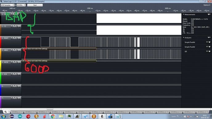

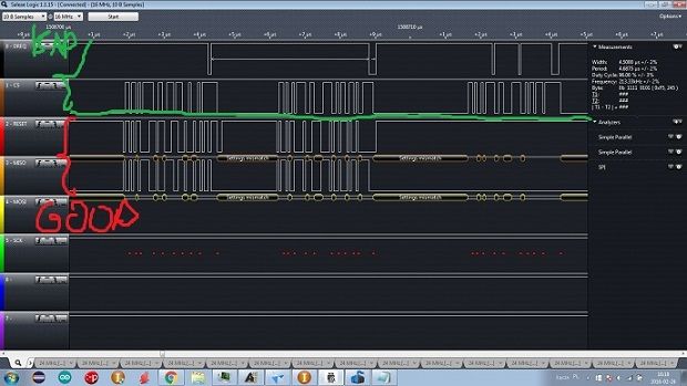

So I decided to sniff the signals with the logic analyser. this is what I've noticed: (3 pics different zoom ( top 2 signals are from the not working one ) :
It looks like the ''ZG'' vesion is faster than the other, but the RCC registers are the same.  What else worries me is the first line ( D+). It differs from working device's D+, but I dont know why. Also the USB registers are the same, besides the amount of frames sent.
I don't know what may be wrong. The paths on the pcb are just a bit longer, and that's the only physical difference that I'm able to spot.
Hope You can help me!
