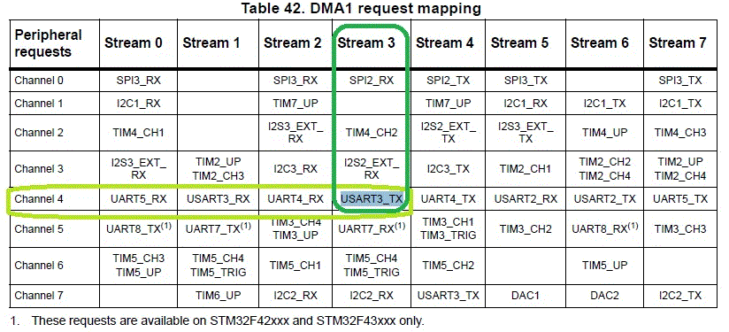

Hello Everyone
I am tryint to send data through usart3 by dma ; I can send data without DMA but when configure to use the DMA I could not send ; Could you guide me to check my mistakes ; the code is :

ivani
Posted on December 18, 2014 at 13:54
It should be:
DMA_InitStructure.DMA_Channel = DMA_Channel_4;
ASSAAD.ASSAAD
Posted on December 18, 2014 at 14:33
Thank you ; I tried 4 too ; but does not work t
ASSAAD.ASSAAD
Posted on December 18, 2014 at 14:52
Thank you Ivan it Works ; I mixed between stream4 and channel4;
I dont use interrupt ; I want to send the buffer using DMA;  but  how can I resend the data again ; everytime I want to send shouldI call DMA_Configuration(); or any suggestion ?

Posted on December 18, 2014 at 15:10
Yes, you would need to reconfigure the DMA transfer for each burst in Normal mode.

Posted on December 18, 2014 at 15:40
Yes, you should reconfigure the DMA before every transfer. At least I didn't find a good way to use it in a circular mode for transmission (for the reception it is possible).
A very direct approach is to supply the address of the buffer and number of characters to a function, which will configure and enable the DMA for each transfer. If the previous transfer was not yet finished it should wait for it, which is the penalty for the simplification.
A more advanced way will be an implementation of a circular buffer for transmitted characters. But because the DMA is used in a linear mode we have to manage it - when we copy the characters before the end of the buffer we set the DMA once to transmit the number of characters. When we roll back to the beginning of the buffer we set once the DMA to send the characters up to the end of the buffer and then when the DMA TC interrupt is triggered - for a second transfer for the remaining characters.
Sounds a bit complicating but works :-).

ivani
Posted on December 18, 2014 at 16:35
Generally, before restarting you need to set again the number of data items, the base address of the buffer in the DMA registers and re-enable the DMA again. But with SPL everything is in a common structure, so all fields should be valid before calling the initialization function. If the configuration structure is a global variable then you may update only the number of characters (you may send different number every time, right?) and (may be) the buffer address if it is different, so you will fill all the remaining fields only once.
