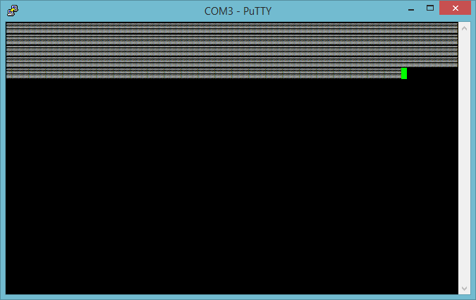

0690X00000605ECQAY.png And as you can see on the attached picture I'm receiving incorrect data. Bascially if I change value sent the characters on the console are the same. I have defined settings for clock configuration and confirmed it is working fine

Posted on January 17, 2015 at 14:11
Can anyone point me to some possible root causes ?
Well there's that 4.7uF capacitor on PA9

Posted on January 17, 2015 at 14:54
However is this somehow document for beginners ?
Well there is the User Manual for the board, which has both a schematic, and a list of usable pins.

Posted on January 17, 2015 at 15:19
If I may just ask on this one. Looking at the table from user manual (from beginner perspective ) I have Main function / Alternate function and board function. And in this particular example PA9 (USART1 TX) has board function of ''VBUS'' and ''GREEN LED''.
So would this be correct If I would say I cannot use alternate function if there is a board function assigned to it ?
Posted on January 17, 2015 at 16:25
Unfortunately ''beginner'' is a bit vague, I'm assuming you're not three, and bring some life skills to the party. Do you have experience with electronics, microprocessors, software, try to provide some context.
You'd want to focus on the ''Free I/O'' pins, the other pins are connected to other things, and so you'd need to review the circuit, attached components, and decide if the current configuration would interfere with other uses, or if you need to remove the components.

Posted on January 18, 2015 at 23:31
At first, the clock source is wrong initilized - your init code enables the clock source for COM3 instead COM1 you handles in your code.
Secount, take care about the bus where the com ports attached. This could a different one - so watch into the manual of the 407.
