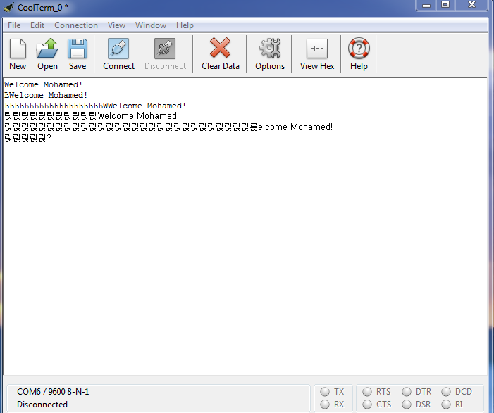

Posted on October 06, 2016 at 03:16
Thanks for your reply. I tried your fix but still the same problem occurs.
here u can find a screenshot of my ouput.
Posted on October 06, 2016 at 04:00
void USART_Float(USART_TypeDef *USARTx, float x)
char str[80];
sprintf(str, ''%.02f'', x);
USART_putch(USARTx, str);
You want the puts version not the putch one.
Posted on October 06, 2016 at 05:39
I tried both of em, putchar return me those weird char, puts return me nothing and the serial doesnt receive anything.

Posted on October 14, 2016 at 09:26
Thanks man, it worked. However, it's weird how it worked and i will be glad if u can explain me how.
The problem was in this function
void USART_puts(USART_TypeDef* USARTx, uint8_t str[])
while(*str) USART_putch(USARTx, *str++);
and this one is working find for sending any string, yet it didnt work but your function works perfect eventhough i guess both do the same.
void USART_puts(USART_TypeDef* USARTx, char str[])
while(*str)
while(USART_GetFlagStatus(USARTx, USART_FLAG_TXE) == RESET);
USART_SendData(USARTx, *str++);
Posted on October 14, 2016 at 14:56
Ok, I see the issue now, I should be using GetFlagStatus not GetITStatus, the defines for the latter are different. I'm also front testing that the TX register is empty before writing to it, not after.
void USART_send_char(USART_TypeDef *USARTx, char c)
while(USART_GetFlagStatus(USARTx,USART_FLAG_TXE) == RESET);
USART_SendData(USARTx, c);
