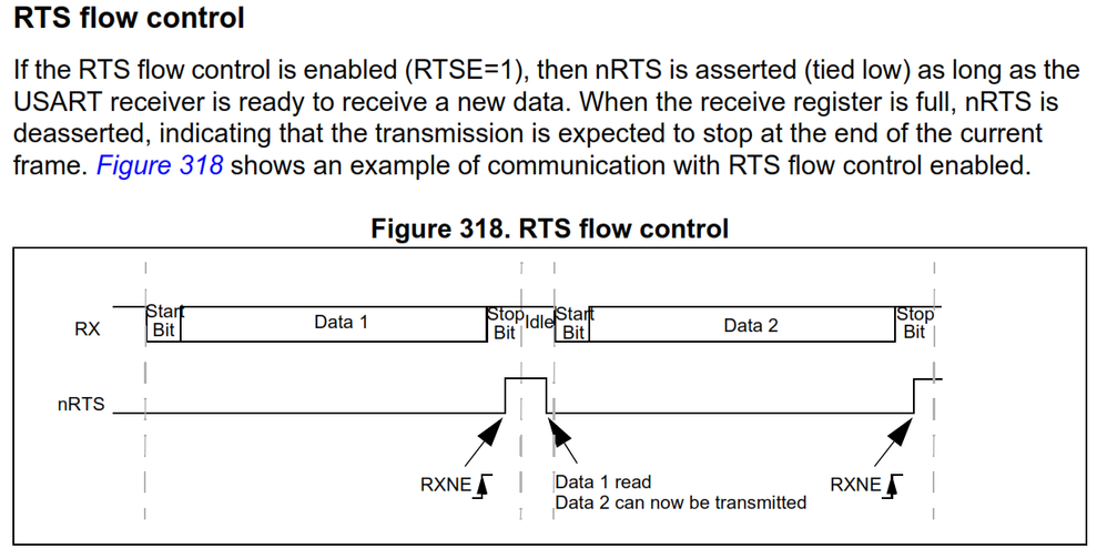

    Using RTS in flow control mode to switch DE (TX enable on transceiver) won't work.  DE has to be asserted for the entire length of the outgoing message (I assume you have a half duplex bus), before first bit is shifted out until after last bit is shifted out.  And no other transmitter can be enabled at the same time.
    You will have to disable RE* to make sure no data arrives while sending, but the difficulty is in receiving a message from a remote node.  RTS asserts when you read the data register and clear RXNE, that's the pulse at the end of a frame in your diagram.  That pulse enables the transmitter, sending whatever the state of the TxD pin is at (usually a SPACE).
    But what happens is after reading the first byte you turn on the transmitter while the second byte is arriving, jamming the bus with multiple transmitters.  Your incoming data is unreliable.
    Yes the RTS pin is used by RS-232 to RS-485 half duplex adapters, but the requirement is RTS is asserted for the entire transmit message, not pulsed for flow control.  That's how the original half duplex Bell 201 modem worked (the reason the RTS/CTS pins are on the RS-232 connector).  Many UARTs have a different RTS mode to support half duplex transceivers like RS-485 or infrared.
