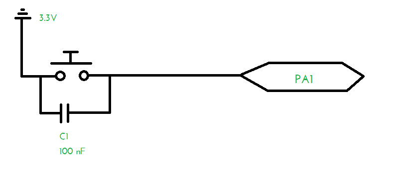

And the circuit I'm using :
When I clicked nothing happened :\
What's even weirder when I unplugged the jumper that connect this to PA1 the function suddenly worked and the LED started blinking !!!
I tried again and seems that connecting the jumper alone to the pin PA1 triggers the function !!! like it's just a wire, why would this happen ?
Can anyone tell me what I'm doing wrong ?? Thank you.

The ground symbol for 3.3V is a bit odd.
The DISCO has 3V supply, I'd probably configure the pin as an input with a pull down, seeing as you don't have one externally.

Print out the level you see via GPIOA->IDR as you press and release the button.

Posted on July 21, 2015 at 01:02
Thank you , I had to set GPIO_InitStructure.GPIO_PuPd  to GPIO_PuPd_DOWN.
