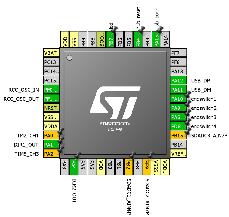

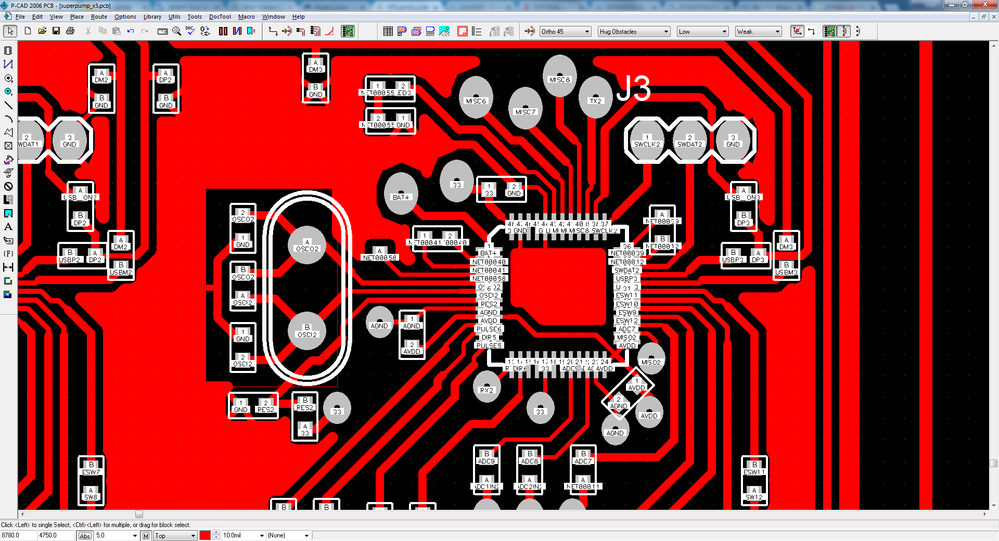

‎2017-07-08 7:59 AM
It's a custom board? Can you show your schematic? Looks not like F373 EVAL board.
Do you consider to refresh your library to CubeF3 1.8.0?
‎2017-07-08 10:28 AM
Yes, this is my own board. I didnt make sch file because of simplicity. I draw pcb looking at CubeMX pinout.
‎2017-07-08 10:52 AM
Товарищ,
It's difficult for me to understand you.
You can layout without a schematic?
You are using CubeMX without generating a HAL/LL project, and still using StdLibrary?
In your project, you are still have stm32373c_eval.c without using it.
‎2017-07-09 4:05 PM
Yes, I can.
I'm using CubeMX just to generate pinout. I don't use HAL.
stm32373c_eval.c is in VirtualComport_Loopback project from
UM0424
ST library. It is in project, but no functions was used, so it can be deleted from project.I downloaded most recent
STSW-STM32121 v4.1.0. No changes - the bug still exist.
Do you have such evalboard?
