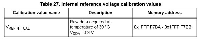

fjanus
Posted on July 22, 2014 at 16:07
Hello Colleagues,
where the heck ist the calibration value to be found?
The data sheet states: ''
To improve the accuracy of the temperature sensor measurement,
each device is individually factory-calibrated by ST. The temperature sensor factory calibration data are stored by ST in the system memory area, accessible in read-only mode.''
Can anyone point me to the right loaction?
rgds
Posted on July 22, 2014 at 17:24
http://www.st.com/web/en/resource/technical/document/datasheet/DM00058181.pdf
