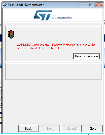

manoj
Posted on January 17, 2015 at 11:51
Flash Loader Demonstration error on (stm32f407 discovery board)
sir i used PB10 and PB11  as serial communication(USART 3)   and connect BOOT 0 pin with VDD and PB2(boot 1) to GND. But its not working and there is a error...............
and also click on Remove protection but warning is still not removed .
 plz help.............
Posted on January 17, 2015 at 14:35
Flash Loader Demonstration error on (stm32f407 discovery board) sir i used PB10 and PB11  as serial communication(USART 3)   and connect BOOT 0 pin with VDD and PB2(boot 1) to GND. But its not working and there is a error...............
And did you read any of the suggestions in the thread before posting against it?
Try connecting manually and report results.
Try using a PC with a built in serial port.
Try using 9600 8E1 (EVEN PARITY).
Try explain how the serial circuit is wired (STM32F4 to PC)
