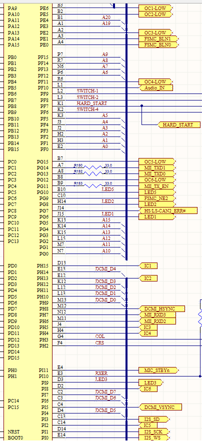

I'm not sure how to remap pins that do not line up correctly with the alternate functions specified in the datasheet. For example, the picture below shows the pin out of my microcontroller where OCx-LOW are pwm out and ICx are pwm in. Comparing it to the datasheet's alternate function listing, only some pins line up to timer channels. For example, OC1-LOW and OC2-LOW pin's alternate functions match up to timer 9 channel 2 and 1, but OC3-LOW and OC4-LOW don't match up to any timers on their alternate functions so I'm not sure how to use these pins with the timers for pwm out/in.
When they match, you can do something like the following, but not sure what to do when they don't line up.
I guess you ask the board designer and review team what they were thinking? The AF muxing fabric has limited connectivity, it does not offer a crossbar-switch type functionality. So if it's not listed, it's not escaping on those pins.
See if you have other free pins in your design where you can escape the signals you need, and add some trace wires to your board.
TIM9 only has TWO channels.
The other alternative is to program them as GPIO pins and drive them via software, providing the speed and placement are less critical.

So I tried this but always seems to yield a 50% duty cycle when I check the OC3-LOW pin with a scope and changing the timer channel 1 pulse does not affect it. Any ideas why this isn't working?

Posted on July 10, 2013 at 21:36
GPIO_SetBits(GPIOE, ~GPIO_Pin_2); // Don't think this works
GPIO_ResetBits(GPIOE, GPIO_Pin_2); // Try this
As for banging things up/down and getting the duty you want, I'd suggest you have the pin set high in the Update interrupt, and low when the CC1 hits. Honestly not sure you can catch the alternate edges in the manner you're attempting.
