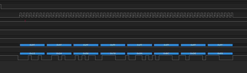

There seems to be an issue with the SPI peripheral in the STM32F10x family of devices.
I have the same issue with multiple devices (STM32F103ZGT8, STM32F107VCT6)
Here is the issue:
When I try to read in master mode, I must send data for the peripheral to send out a clock so I can read the data.
When I am reading data, I am reading back what I sent.
I have used the SPI in interrupt and with DMA and have the same issue.
When I try to write/read, I read the first byte properly, but then I read back what I placed in the DR register
Using a logic analyzer, I was able to see that my master and slave are transmitting the bytes properly.
From this stream, I would expect to read 0xFF 8 times.
However, my RX buffer will contain: 0xFF 0x12 0x34 0x56 0x78 0x9A 0xBC 0xDE

The odd thing is that we get a TXE interrupt (step 2) even though we are still transferring the first byte. This means that we have not read single byte but we have already given the SPI peripheral 2 bytes.
Here is thehypothesis I have arrived to:
It seems that the DR register overwrites the data in the RX buffer if I write to it too soon.This makes the use of the DMA for reading data useless.

I might have phrased my question wrong, but I would like to use the SPI in full duplex mode using the DMA.
Somehow, the read of the SPI doesn't seem to work, because as I have mentioned, I am reading back what I sent (so it's as if RX and TX buffer are the same). If you look back at the logic analyzer screenshot from my original post, I should be reading 0xFF 8 times, but it's not the case.
Any help would be greatly appreciated!!
