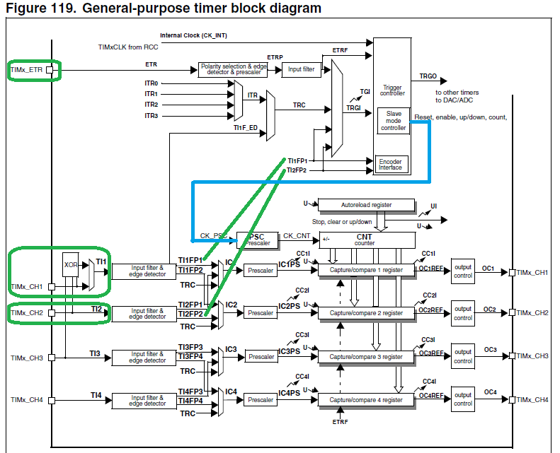

Im currently trying to read a incremental encoder via timer3 (channel3/4). Im working with a STM32F103RBTx.
The encoder is connected to PC8 and PC9.
If i connect the encoder to PC6 and PC7 (Tim3_CH1/2), then i can successfully read the encoder value. But since im going to use PC6/PC7 otherwise, im trying to do the same thing with Tim3_CH3/4. (Funny thing is, the encoder_counter can still be read on PC6/7 even if i configure GPIO PC8 and 9)
Is there something missing?
A whole bunch of imagined connectivity? The diagram for the TIM only shows routing for Channel 1 and 2
You should also qualify the source of interrupts, and clear them early in the handler, clearing them as the last thing before exit exposes you to a race hazard.

where do you mean that the code is routing for channel 1 and 2? thats what im looking for, the route channel 3 and 4 instead.
Posted on November 30, 2015 at 19:50
I'm saying there is no connectivity for channels 3 and 4 with respect to Encoder Mode.

ah thats it. thanks clive.
