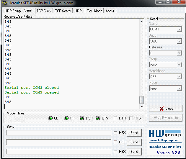

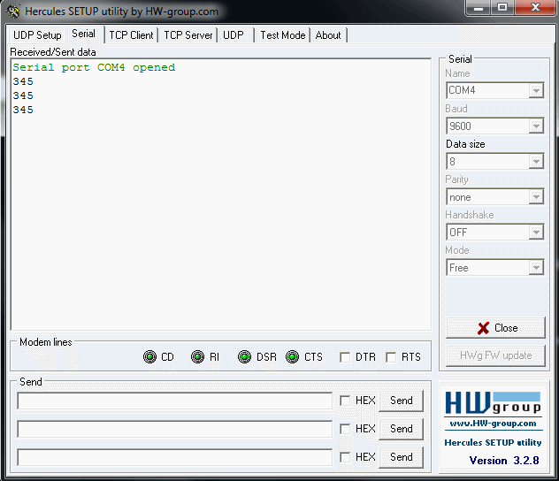

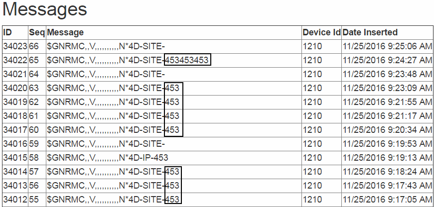

Here is , which data I want to send with stm32f030 0690X0000060MnbQAE.gif Here is, What I get with stm32fAs you see the data is coming correctly. 0690X0000060MncQAE.gif This image is from my server, I am trying send this data (345) to server with GSM module and as ı mentioned above it skips first character of (345) in the beginning and add it to the end of this string. 0690X0000060MndQAE.gif
