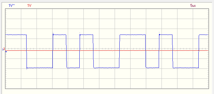

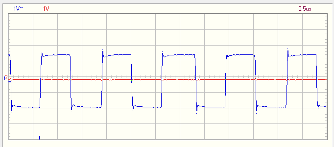

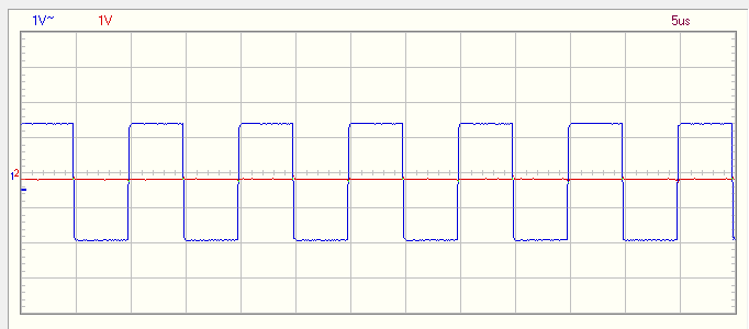

Here are some results:
MikroeC , 5 usec
Atollic + HAL , 5 usec (IMO far from perfect)
MikroeC , 0.5 usec (not perfect!)

‎2018-07-06 6:09 AM
I can toggle the port pin (
GPIOC GPIO_PIN_9) every 5 usec. but not every 0.5 usec.
‎2018-07-06 7:15 AM
think about what's involved with an interrupt invocation (aka interrupt overhead) and you will know.
‎2018-07-06 7:22 AM
Atollic + HAL , 5 usec (IMO far from perfect)'
your original statement about having to program the registers directly in MikroC answered that perfectly.
