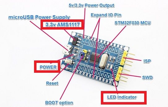

Any ideas why this board consumes 3.3 mA in StandByMode even if there's nothing plugged in? I already desoldered the AMS1117 and the on board leds.
Same goes for the STM32F103C8T6 I have. Both using around 3-4mA even is they supposedly are in standbymode. Im pretty sure the MCU enters standbymode since I tested it with a blinking led. Once the MCU entered standby the blinking stopped. When running the code the current draw is around 6mA.
